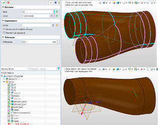

Hi Paul,
run on win 11 pro + zw3d 2026 SP1 and seems fine. As already reported I also noticed big tolerances values on “add6” (1mm) and “add9” (0.8mm). I could reduce the value on “add6” to 0.01 and the model was updating fine; “add9” instead I kept unchanged as lower value did not work.

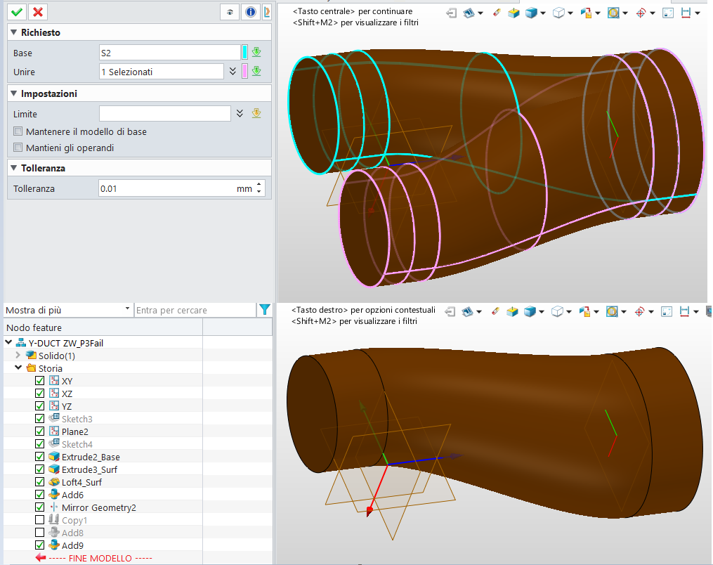

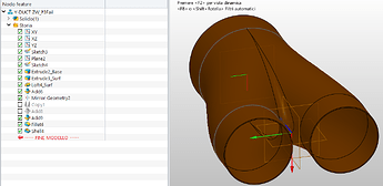

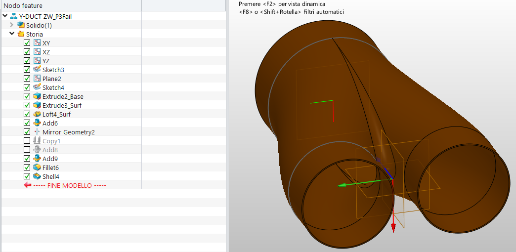

Sure,
I tested the “add6” tolerance from 0.001 mm to 1 mm, and it works fine.
“add9” starts working at a tolerance of 0.03 mm.
With a lower tolerance, the operation doesn’t return an error—it completes—but the mirrored object disappears (see image)

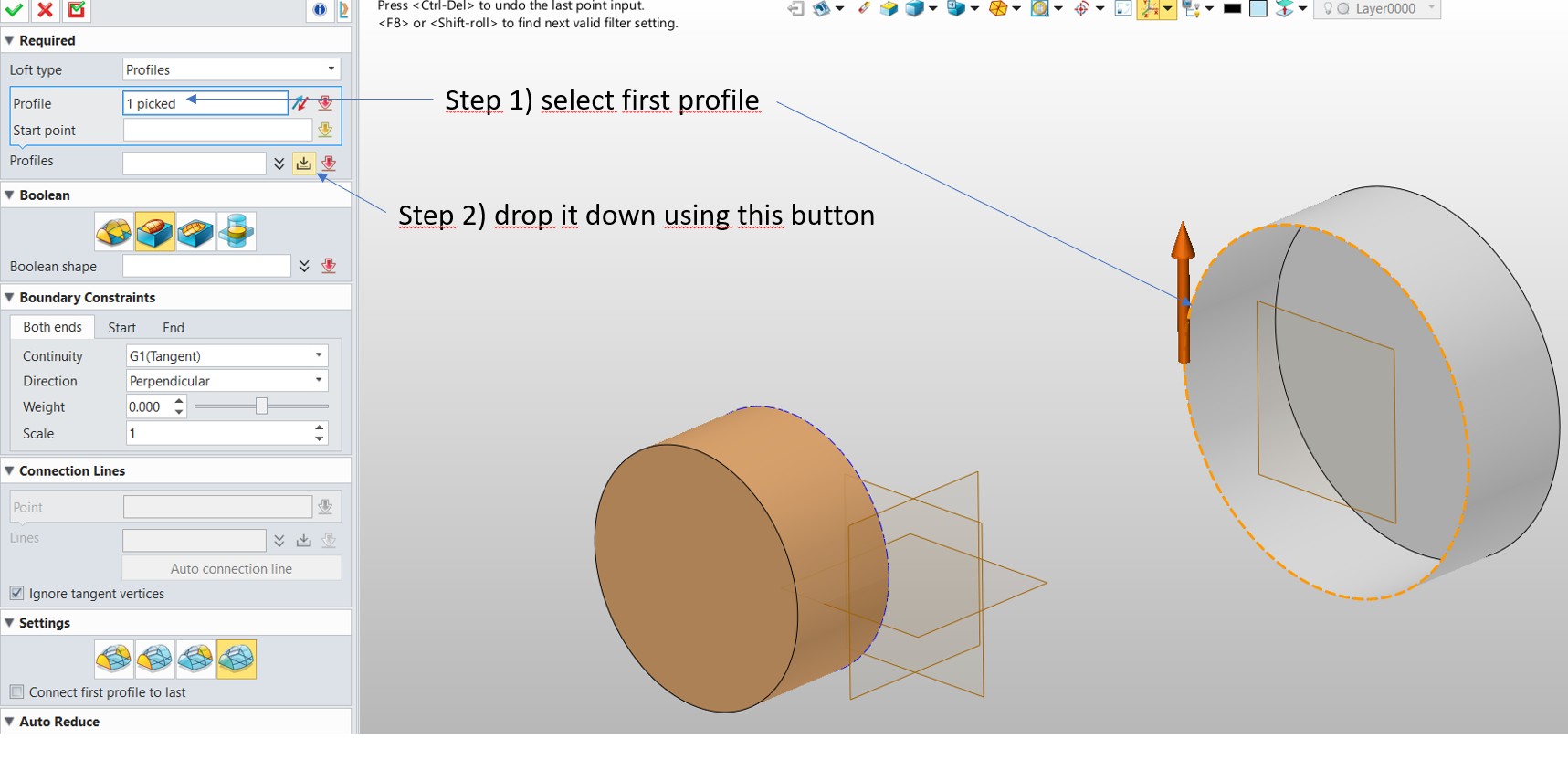

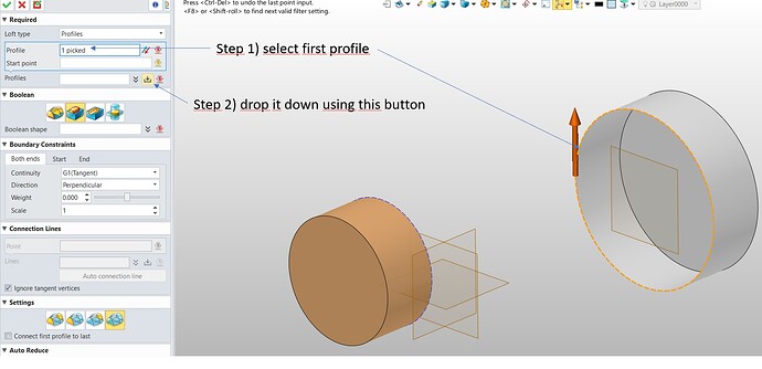

Hi Paul,
regarding the profiles selection in the loft command, I have been using only ZW3D 2026 (I am actually a new user) and I found a bit counterintuitive the profile selection. In my case (SP1) I need to select each profile one by one and drop it down as shown in the picture below. Was this different in previous versions?
Hi Ropa, what you are doing is as you say not intuitive until you understand Z3 is RMB (options)and MMB(confirm and/or repeat) centric.
So Confirm completing of selection with MMB then make second selection, then MMB to confirm.
With Z3 if in doubt
The issue is selecting more that one shape to Boolean. Previously we can select multiple shapes to add - in this case - both end caps.
