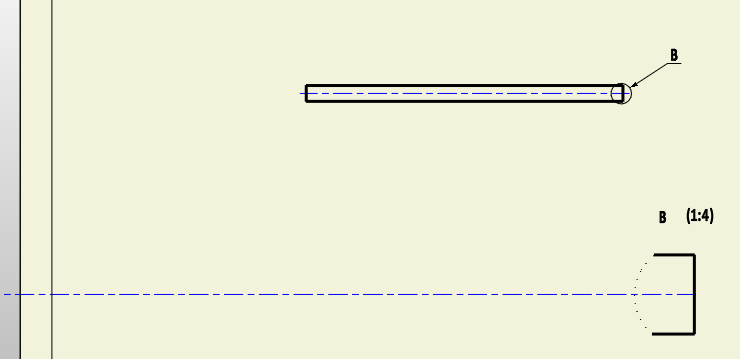

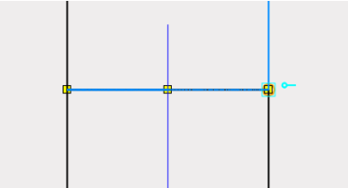

  1. If you create sketch in 2D drawing following on existed view (like on the picture), you can see the constraints.
However, if you change the dimensions of the model, and therefore the views in the 2D drawing, the sketch will not reflect this change.
Is it somehow possible how to make these constrains functional and sketch dependent on model view?

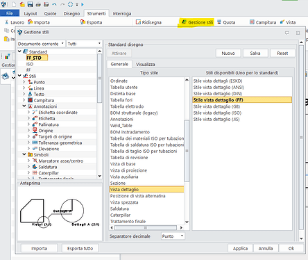

  1. I have a colleague with the same version (ZW3D 2026). If he creates a detailed view. It has an axis as long as the entire uncut view and it cannot be shortened. But I don’t have this problem, everything is ok for me, so I think the problem might be somewhere in the settings , but I don’t know where. Do you have any idea?

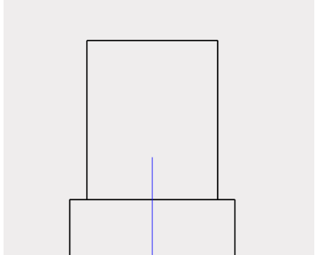

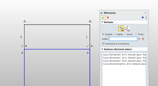

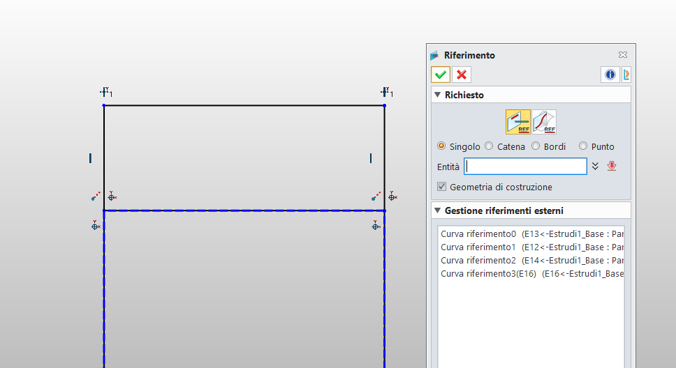

  1. This is a sketch on a 2D drawing.
    If I set the reference geometries and update the 3D model, the sketch adjusts accordingly. (see image)
    It’s likely that what you see are snap points, but they often aren’t automatically constrained.
  2. It’s possible that the styles have been modified. Try checking under Tools → Style Manager
