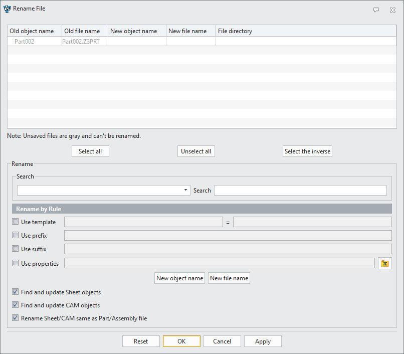

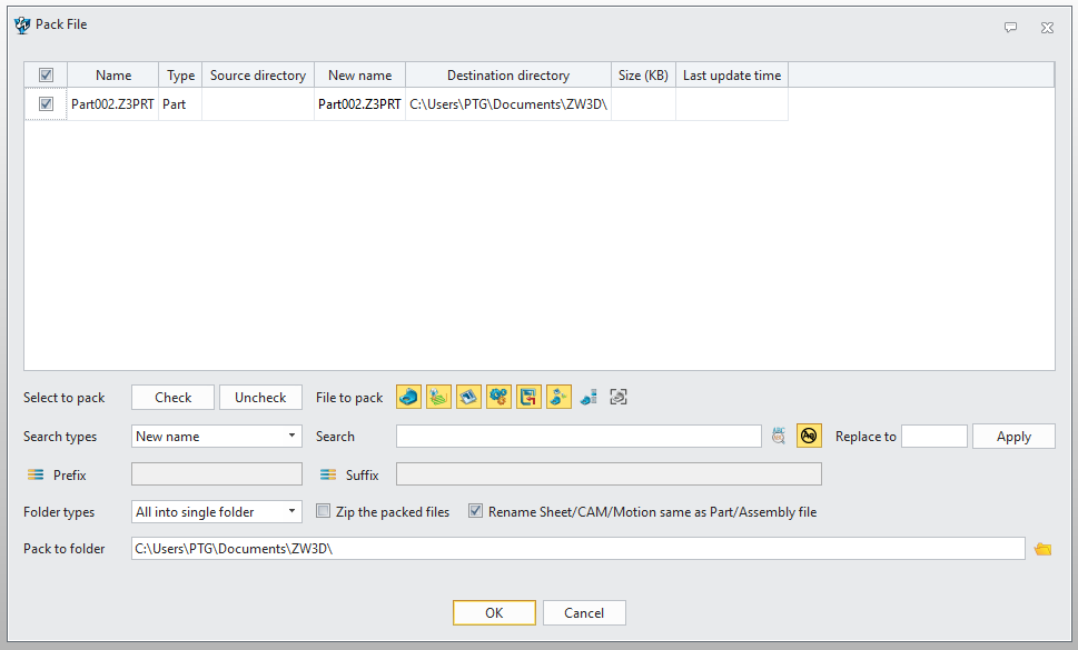

HI
I suggest you modify the use of this naming association problem.
OR
So they should be able to correlate updates
If it is wrong, please provide pictures to show your intention, language differences, I don’t understand what you said very well.
