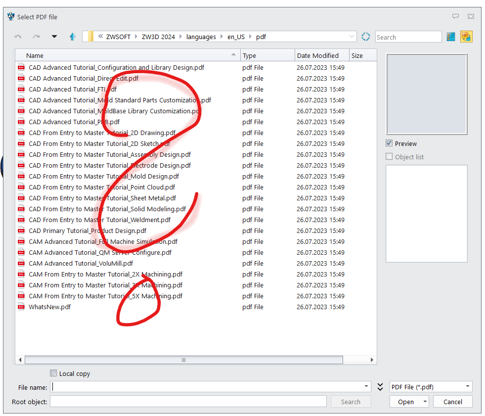

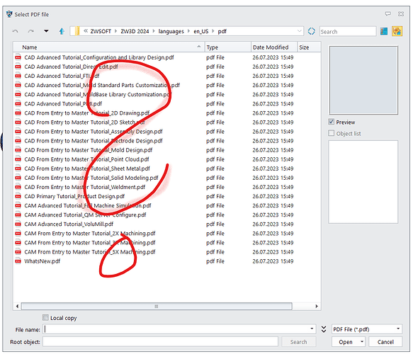

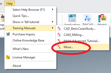

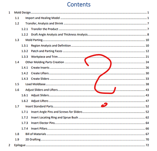

Hi Torsten, there is no documentation for the working with a mold project in ZW3D.
Hello Torsten,
please take the PDF-File:
CAD From Entry to Master Tutorial_Mold.pdf
Best regards from germany
Gordon

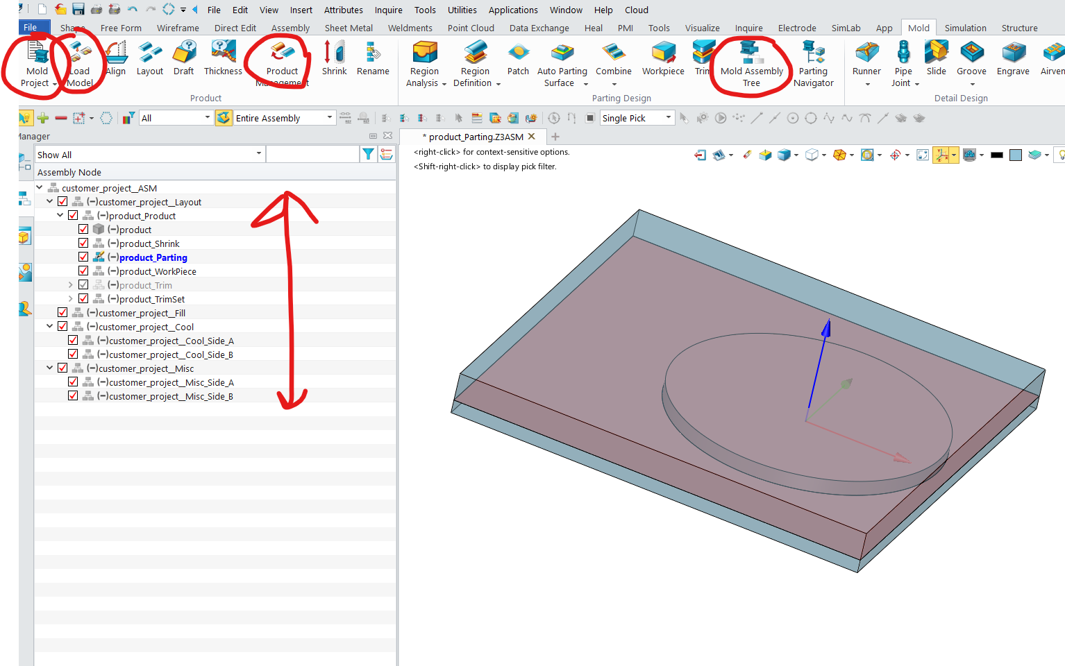

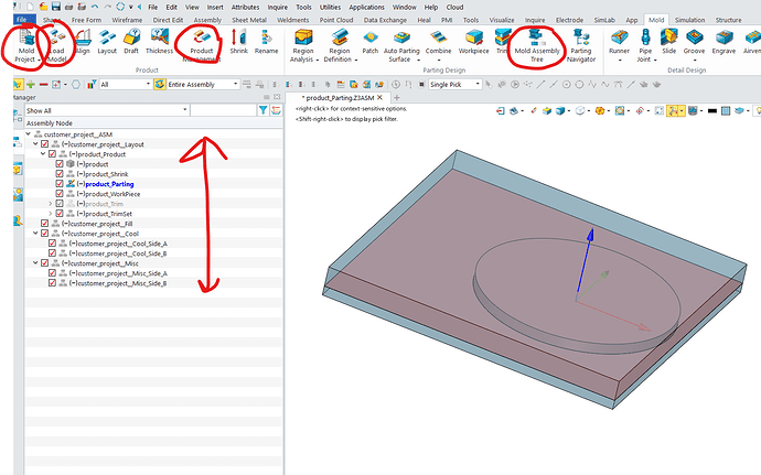

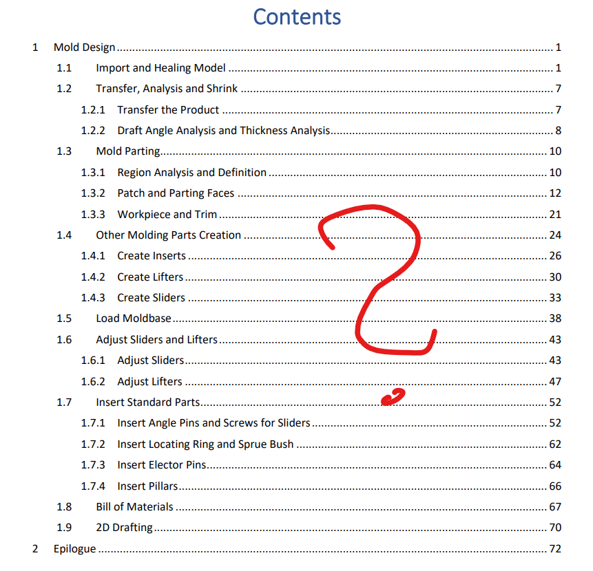

Hi, all these articles are about mold design, but the guide, in some parts, is a bit outdated (I mean, it wasn’t created with ZW2026). So the mold making flow is slightly different from the one shown in the guide.
When I make a mold, sometimes I follow the commands and other times I have to find some workarounds.
