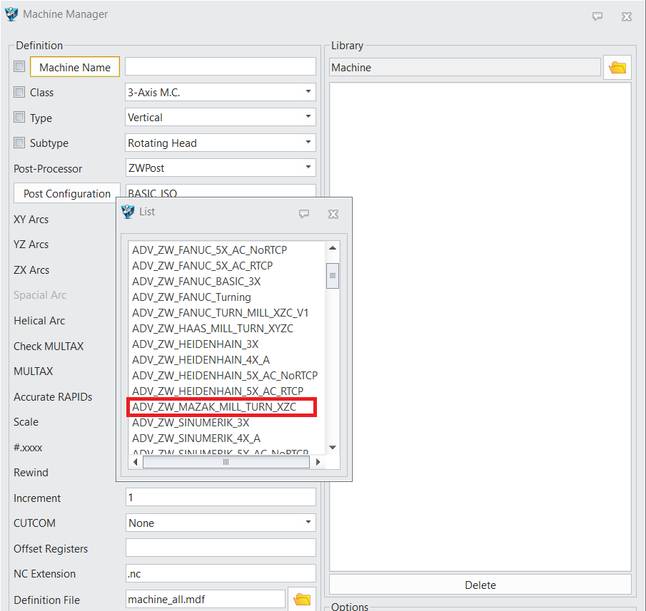

Is the ZW3D CAM can use to creating NC Code for Turnmill machine ? Basically using X,Z and C axis ? If anyone have the experiences using ZW3D CAM to creating it, please share to me
yes, it is possible. There are some predefined postprocessors.
And if i remember correctly, postprocessor for your machine is included in CAM version price directly from ZWSOFT.

Anyway, except than movement the sub spindle, is it properly running by ZW3D CAM for turn-mill process right ? Including the simultaneous cutting process ? Maybe using A/B/C Axis ?
Hello, sorry for delayed answer. I am not sure, try to contact resseler in your country or ZWSOFT directly. Or try predefined postprocesors.
