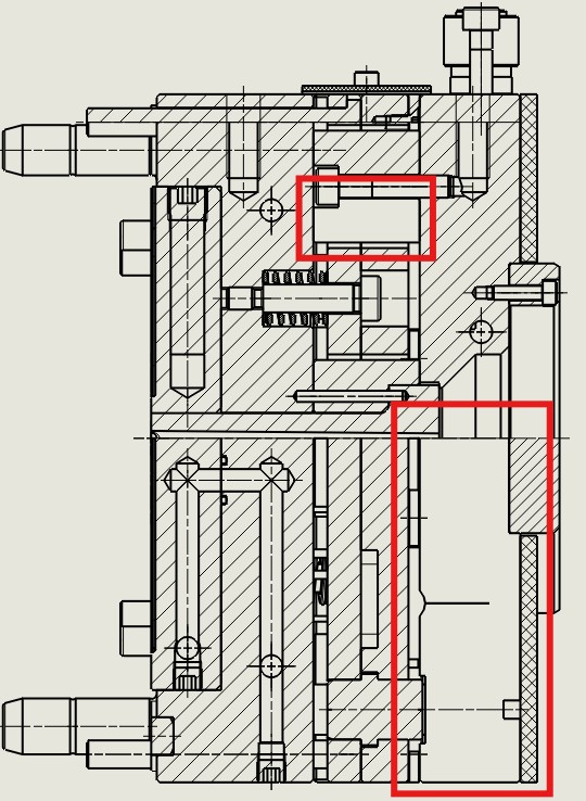

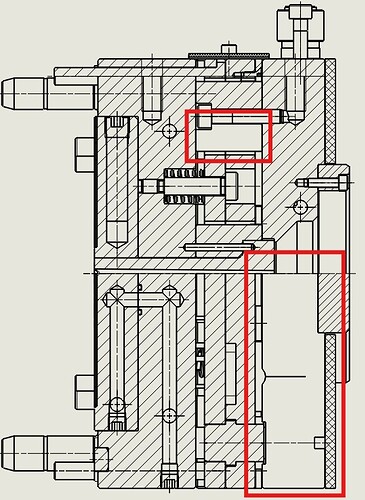

Hi, sometimes after drawing view regeneration some hatches are lost. Part of component is hatched, part of the same component no - hatches are lost or hidden. Is there any way to show hidden hatches? Command “Show all” does not solved this.

ZW3D 2026 Lite. After section view crating I turn off option “Dynamic hatch scaling and angle” because I want to have all hatches under 45°/90°. Then I change spacing for selected hathes for better coponents “recognizability”.

I also have this problem quite often. Forced to patch these hatches manually
