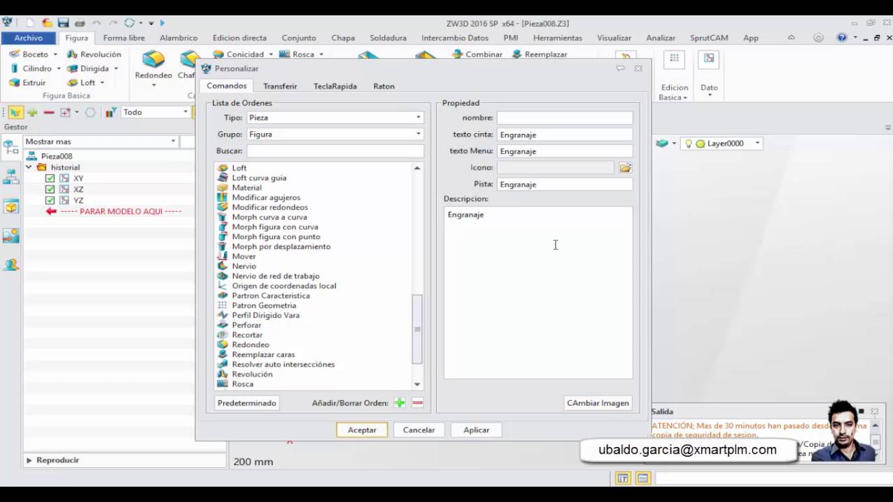

there is a document with a lot of information but no tutorial. Is called Macro.doc but this forum not allow to attach .doc. This doc contains 41 pages.
For the 2019 the path is C:\Program Files\ZWSOFT\ZW3D 2019 (x64)\languages\es_ES\text
For the 2020 is C:\Program Files\ZWSOFT\ZW3D 2020\languages\es_ES\text
Moroeover in youtube there are some tutorials from XLSMART:
With all of this an pacience you can make macros, learning from your own.
