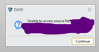

hello, i want to change the overall folders name of loads of other folders and drawings, when i do so i get a sourche file error, is there a way to solve this.
or should i just stick with the old name

Hi Mark, are you using One Object per file mode?
If you move files around and rename externally, ZW will struggle to find them becuase it doesnt know where they are.
Opening and resaving Multi Object files in a new location with a new name works But you need to delete the old files and OR force File Search Paths to only look in one location and its subfolders (if any).
Read the Help on Search Paths to get a clear understanding.
The basic Rule is ONLY change things from within ZW. 2022 tools for this may not be as good as 2024 and beyond.
