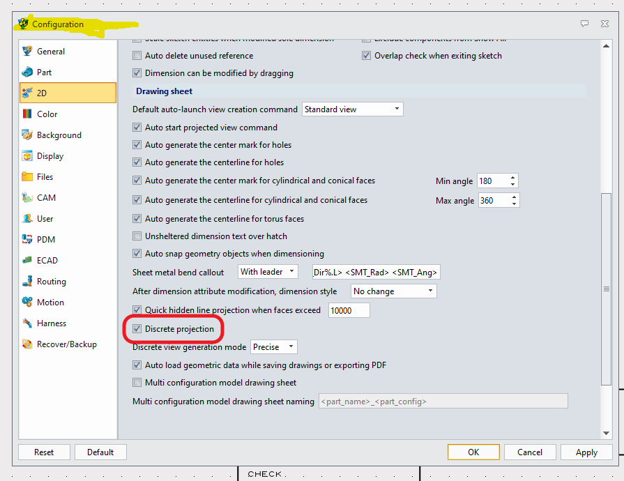

To check, Utilities/Configuration/2D - Drawing Sheet…

Config setting location.
