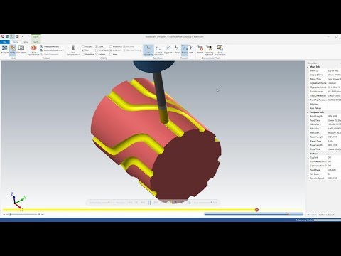

Does anyone know if there is a function similar to Mastercam’s “axis substitution” in ZW3D? The intention is to try to leave the Y axis locked and only work with the movement of the A axis.
At minute 5:48 of this video you can see the example.
Thanks.
