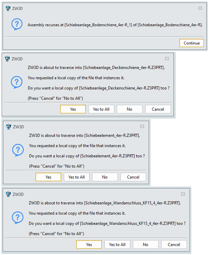

I have got this error message trying to open an assembly:
Assembly recurses at [Part name of an assembly_1] of [Part name of an assembly].
Does any one know why I am getting this error?

Hi Mamuel,
thanks for taking time.
I never use any files with the same names.
I have made a change in my working process.
In some assemblies I had sub-assemblies that are in a sub folder under the working folder.
I have moved these to the working folder so that ZW3D get direct access to all the files needed.
It seems that it’s working properly now.

Hi,
I have found an old assembly with the same problem.
Now it’s working fine after making sure, that all files of Sub-Assemblies are also in the same working folder.
