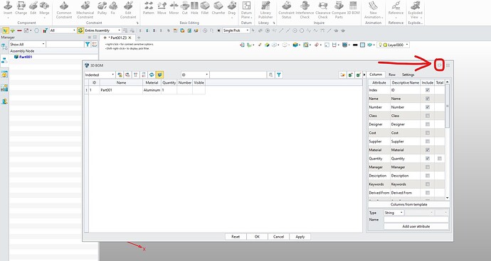

Yes you can.
See the file “Default.Z3DBOMTT”, “ExportConfiguration.txt” and “zw3d.xlsx”.
This provides template settings for BOM, attribute preset values, Excel export format, etc. After setting, the related content will be generated by default using the defined template.
Or click on “Help” (see image) to learn more:
